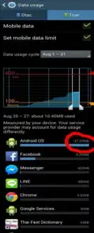

I have already read this and this but can't stop the automatic blackground update.
I currently use Samsung grand 2 dual (SM-G7102) android 4.3 and cellular mode.
I'm setting-->usage “Restrict Background data” but the android OS is still running the updates in the background.(see picture) help me please.
Click image(s) for larger version
I'm setting “Restrict Background data” in 24/08/2557 but On 25/08/2557, "Android OS" was still sending out to cellular.

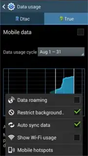

I'm allow Facebook, Line and Messager can use cellular but don't want the "Android OS" Update. The mobile is rooted
The "android os" was “Restrict Background data”. Help me please.

  • your 2nd screen shot is not clear from what you want. Could you please update your screen shot without the notification bar sliding down and add another screen shot for the options that are enabled in the shortcut bar. – user285oo6 Aug 27 '14 at 05:44
    Put Auto-Sync in Settings to off. – ProPlayerMaxUltra Aug 27 '14 at 06:30
  • update picture and detail. – ohno Aug 29 '14 at 02:58

Go to Settings → Data usage → click on the 3 vertical boxes in right top corner → tick the Restrict background data → then remove the tick in Auto sync data.
