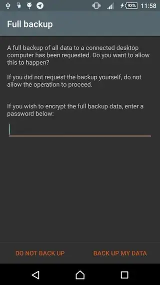

I managed to do an adb backup of my phone based on @sameer's answer. However, as noted in the comments there, you need to confirm the backup using the screen after running the adb backup command.

Now run the adb backup command:
# adb backup -apk -shared -obb -all -system -f ./android-backup.ab
Now unlock your device and confirm the backup operation.
Next, you'll have a screen like that one (click image for full size):
backup screen
So now, we will press "TAB" twice to get to the "BACKUP MY DATA" button, then press "ENTER" to confirm. Basically, based on the numbers in that answer:
adb shell input keyevent 61
adb shell input keyevent 66
Now your backup has started. Yey!
