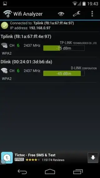

I have a wireless router (D-Link) in room A and a repeater (TP-Link WA750RE) in room B, both having the same SSID. Sometimes, when I go to room B and back into room A, my Nexus 5 (Android version 4.4.3) doesn't switch to the router although it has a stronger signal. It stays connected to the repeater instead.
Screenshot
The "Tplink" and "Dlink" are only aliases. Both actually have the same SSID.
When I switch the Wi-Fi off and on again, it connects to the router. which provides much better speed.
How can I force Android to always switch to the strongest signal? Is there a setting for it, or an app?

Android 4.x will connect to the strongest available network when first connecting, but, by default, once connected, it will not change networks unless it loses its connection first. This is presumably because switching would involve disconnecting existing connections, and a second or three of no network.
Turning on "Avoid poor connections" in the Advanced Wi-Fi settings will make Android switch if the network reaches a low enough signal to trigger this feature, instead of waiting until it is gone completely.
One solution might be to set up a single SSID with two access points that support hand-off, rather than two entirely separate Wi-Fi networks - which is the way that this sort of scenario is handled in large commercial settings - but this depends on the hardware that you have.

    Actually, both of these devices have indeed the same ssid. As I said in the OP, the tp-link is just a repeater. – ercan Nov 17 '14 at 10:53
  • Are you sure? I'm not a networking expert, but it looks from your screenshot as though there are two networks with two SSIDs (one called "TPLink" and the other called "Dlink"). Presumably the repeater is creating a second wireless network, and bridging between the two? – Flyto Nov 17 '14 at 12:24
    Actually those are the aliases I assigned in the WiFi manager app so that I can recognize the devices on the graphs. Sorry for confusion. – ercan Nov 17 '14 at 13:44

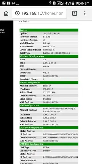

I have 2 routers, one is D-Link DIR-816 dual-band and the other is D-Link DIR-803. The 816 is used as a repeater and is connected with my neighbor's router with whom I am getting internet and the 803 is connected with the 816 as an AP.
The solution I found is to match the security on both routers. The 816 has the option of automatic AES and TKIP, but I set it to manual AES. Both SSID names and passwords are same.
I tried the same thing with TPLink TL-WA801ND as an access point and I got the same result. Even the 816 is set to 802.11 b/g/n while the 803 is set to 802.11 b/g, but matching security works.
The settings page' screenshots are attached:
