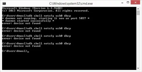

  4. On your computer execute adb shell netcfg usb0 dhcp [PROBLEM]
When I execute adb shell netcfg usb0 dhcp it says: error: device not found. I tried the same thing with USB Debugging in Developer settings, ON & OFF. The error remains the same.

EDIT: I've tried the method suggested in answer, at the 4th step of method 2, I'm facing this problem:

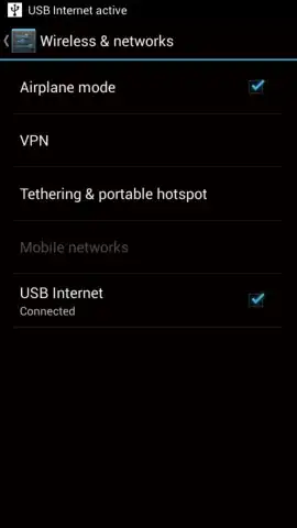

  1. Connect your Android device with a USB-Cable to your PC
  2. In the Wireless & networks section (you might need to click on "More..." on some android devices), Try to activate the USB Internet
    Activate "USB Internet"
  3. Instructions will appear. Select Windows 8 and just click on Next and Done, ignoring the given instructions
    Select Windows 8 and Click on Next Click on Done ignoring the steps
  4. Now, there should be a check-mark after USB Internet:
    USB Internet should be now checked

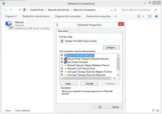

3. Share the Internet Connection on Windows 10
As you can see, there are now two Network connections, so the sharing Tab will be now available:
Two network connections
  1. Right-click the first Network Connection and open the Properties Open the Properties of your original Network Connection
  2. Now, there's a Sharing Tab and you can Allow your Android device to use the Internet connection of your Windows 10 PC
    The Sharing Tab is now available

  • I've posted the edit after trying out what you suggested. Please check it out. I've tried the method suggested in answer, ar the 4th step of method 2, I'm facing this problem – claws Jun 15 '14 at 04:51
  • Sorry for the long wait on the response (hell week at school right now), but the error seems to be that adb can't see your device. Now usually its a driver issue when this occurs, but there is also a chance that it could be a hardware problem (my nexus 7 for example can't connect to computers anymore). What is the output you get when you run "adb devices"? – Colin Jun 17 '14 at 12:56
  • Also this thread may prove useful: http://forum.xda-developers.com/google-nexus-5/help/diagnosing-usb-driver-adb-issues-windows-t2514396 , its for the nexus but it might have some more information if your driver isn't the problem – Colin Jun 17 '14 at 13:08

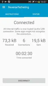

There is a solution for unrooted devices
I know this is a late answer, but as all existing answers suggest that USB reverse tethering is only possible if either your device is rooted or has system support for reverse tethering, I though it'd be worth pointing out there's one more option:
A few months ago, I was looking for a solution that would allow me to use my laptop's Internet connection on an unrooted Android device, but I just couldn't find a solution. Eventually, I started to develop my own solution. The result is an app that works on devices running Android 4.0 or higher on client side, and all major desktop OSs on the host side.
The ReverseTethering NoRoot app
The app is available on Google Play: ReverseTethering NoRoot

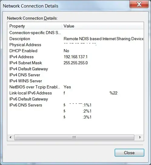

I tested first method on ZTE V987 with android 4.2.1 and, after a little search for RNDIS Interface and another MTKandroidUSB device (ADB Interface) drivers (for windows Xp), it worked. I think you don't have the phone drivers installed in windows. Have you checked in Device Manager?
I have tested first method also in Windows 7 and I installed the following devices:
MT65xx Android device
then I have shared the Internet connection, but without success. The phone did not want to see the connection. Then I have changed the drivers with those from http://www.digitbrunch.com/android/how-to-root-micromax-unite-2-a106 (Driver_Auto_Installer_v1.1236.00) and I have tried to bridge the 2 network adaptors and I have obtained next configuration: Driver_Auto_Installer_v1.1236.00
Then I have reverted to Internet Connection Sharing and I have tried the following commands (found here http://forum.xda-developers.com/showthread.php?t=2287494) : adb shell netcfg rndis0 dhcp
And the phone's USB connection began to operate:
Lan3Status Lan3Details
Finally I have re-updated the usb drivers to the initial Alcatel version, deleted MAC Bridge Miniport, set same DNS for IPv4 RNDIS Local Area Connection and used a .cmd file with adb shell netcfg rndis0 dhcp command to start the connection.
Lan3Details2
