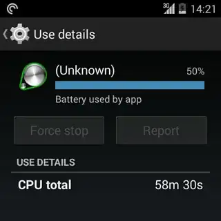

I have a Samsung Galaxy S2 that I upgraded to 4.4 a couple of days ago. Since upgrading, my battery longevity has dropped a crazy amount. Just this morning, it took about four hours to go from full charge all the way down to about 25%, and that's without much use. Previous to upgrading, I could go for about two days while listening to podcasts and writing emails and general normal use.
I looked in the system settings under the battery usage, and discovered that some "unknown" process was responsible for 50% of my battery use:
unknown battery eater
I clicked on the process to see if I could kill it, but the option to "force stop" was greyed out:
battery eater won't die
I tried rebooting, but, near as I can tell, it's still there, eating my battery.
How to I put a stake in the heart of this vampire process and make sure it never returns?

    Since the icon represented by Unknown seems to indicate a system app of some sort. Are you rooted? Have you checked this Q&A? Or use Better Battery Stats to determine the culprit? – t0mm13b May 13 '14 at 19:00

If you are rooted, I would recommend downloading Better Battery Stats (or Wakelock Detector) from the Google Play Store, and finding the name of the 'mad' processes.
If you aren't rooted, I recommend you root as other apps can't access battery stats as of Android OS version 4.4.

It's understandable that your battery life will decrease when you run 4.4 on an older device like the S2. But that is strange. Try identifying the process like the other users suggested. I would also suggest Greenify, an app that can put processes and apps into automatic hibernation, decreasing their CPU toll.

Interesting! Never seen a phone that didn't list 'Screen' as biggest drain. I'd try uninstalling apps until it's fixed, my theory being that some cheesy app (spyware?) keeps calling home. Start with the running apps list--anything running that shouldn't be? Got GPS turned off? How much free storage do you have on the phone? If the phone's memory is nearly full it will overwork itself, in my experience, perhaps defragging. If none of that fixes it to your satisfaction then I'd wipe the phone clean and start over. Let us know what you find out!
roebling
That's very interesting. Have you looked for the "Unknown" app in your Application Manager? That may shed some light on the subject, if it can or can't be found anywhere in there. Other than that, look at some recently downloaded apps, see if they have any weird numbers in the App Manager.
A very puzzling problem indeed.
Even without root you can run a shell for example with "Material Terminal" and run "top" e.g. running "top -m 10" you can see if there are any apps using a lot of CPU.
