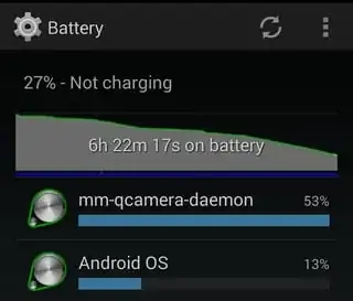

Recently, mm-qcamera-daemon has been causing massive battery drain on my Nexus 5, and making it become rather warm. At the same time, the camera appears to be locked, meaning opening the default camera app (or any camera app) causes the alert Camera is currently in use to appear.
Numerous forums around the web site apps such as Snapchat and a Yahoo video app as the issues, but I've never installed these apps before.
Restarting the phone does seem to fix the issue, but after awhile (more than 12h) later, the battery starts draining again.
Screenshot

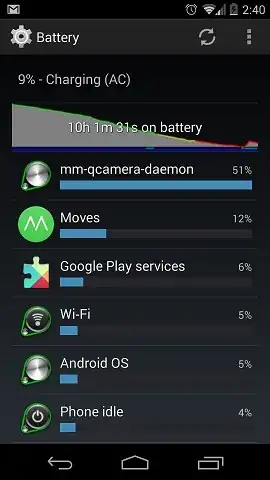

I had the same issue on my Nexus 5 (stock). mm-qcamera-daemon was draining 50% according to battery stats. The issue started when I tried to take photo from Hangout app, camera could not started. I don't have Snapchat or use Skype for video call from my phone.
I went to Apps and cleared data for Camera app.
Old: By far, I now see the percentage dropping to 24%. My phone does not get hot when using other apps as it did while qcamera service was running.
New: mm-qcamera-daemon is not even in the battery stats list. 2 days by now. I regularly use Hangout app, which initially triggered mm-qcamera-daemon.
