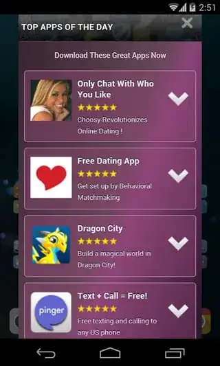

I am getting these popups regularly. They do not appear in the notification center so I can't find out what app is causing them. The only app I can think of that I have installed recently, I have already deleted and they still appear. I am using the Nexus 4 Android 4.2.2. None of the ad detector apps have found anything.
How can I determine what is causing this?

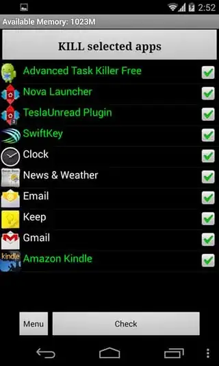

Here is a screenshot of an ad, and a screenshot of my task manager immediately after. I am not sure if the app would have to be running to show the ad:
The ad The task manager
