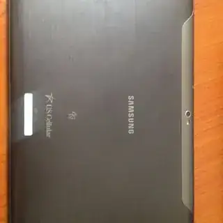

I have a Galaxy Tab 10.1, Model SCH-i905/U from us cellular (image1).
In order to root it, and after an internet search I flashed the device, corrupting files left and right. That's when it can't even start up anymore. It is stuck at the load screen Samsung GALAXY Tab 10.1 (image2).
enter image description here [enter image description here4
Click images for larger variants if needed :)
I have tried about every method on different forums and I am unable to find the factory firmware for this specific model or get it back to stock.
I can get to downloading mode and use Odin. The only file that this software show “PASS” on green is PDA_SIGNED_P7105.tar.md5. Before, it was just stuck at the boot screen with yellow triangle.
I followed the method with PDA_HC31_EG01Ba_AP352081user_CP1033580_LTE20110704_0708.tar but that was failed. Then it won't boot up and stays in infinite boot-looping on "Samsung" logo. I can't get to fast-boot. recovery give me error message in image below:
photo photo
photos (click images for larger variants)
