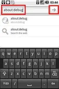

  1. Open Stock browser (Not Chrome on ICS. about:debug doesn't work in Chrome. Use remote debugging instead.)
  2. In the address bar, type about:debug, nothing should happen, there will be no confirmation screen or flashing green box telling you that you've done anything.
  3. However, there should now be a few new options in the browser's Settings page.

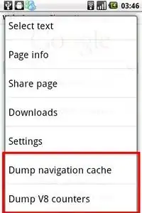

In Menu > More, there is also:
(Click image to enlarge)
probably there are other new menus showing up that I haven't noted and the menus are very likely to be version specific.

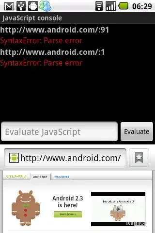

Javascript Console is this thing:
For some reason, the "Show JavaScript console" bar will only show up in android.com website. Not sure whether the Syntax Error triggers the console or if there is another reason why it shows in android.com and none of the other sites I've been checking.

    I can confirm that the console option shows up only when a JS error is triggered. Here's a simple jsbin that triggers an error (and loads a lot faster): http://jsbin.com/owecey – Jörn Zaefferer Jan 21 '12 at 11:54
    I am unable to see the console on my HTC thunderbolt after doing about:debug and going to http://jsbin.com/owecey .
    Does anyone have any suggestions?
    My Android Version is 2.3.4,
    and my HTC Sense Version (if it matteres) is 2.1
    – bnieland Apr 27 '13 at 12:20

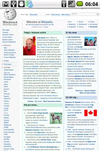

Single Column Rendering causes Browser to use a different layouting algorithm.
I'm not exactly sure what the algorithm's logic is, but it seems to be an attempt to force a website that were not designed for mobile to render in a single column for easier viewing on small screens. Not sure if that's the case though, since enabling single-column view breaks the layout of android.stackexchange.com and disables text reflow, which makes reading much more painful than when using the default layouting. It seems this feature is not used for a reason, I cannot find a single web page that looks better when rendered in Single column rendering mode; even pages optimized for mobile views looks better in default than in Single-column mode.
The following are some screenshots comparing default and single-column rendering, the screenshot on the left are in no-single-column the screenshot on the right are the same page with single-column:
android.com
Wikipedia today's front page Mobile View:
Wikipedia today's front page disable Mobile View:
