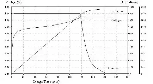

especially on a rapid-charger, this is normal charging behavior to achieve complete 'depth' of charge. I wish they wouldn't report it as "charged/100%" if it was still trickling.
Here is a graph of the charge curve. note the voltage on the battery tops out but the current is still drawn.
charging
It's somewhat an EE question, but higher voltage is provided to the battery until the charge rate (current draw) drops to 5-2% of C, with C being the total storage. IE, on a 3000mAh battery this would be a charge rate of 60mA. Lower cutoffs (1%) are detrimental to battery health (IE, over 3-500 charges degrades capacity by, oh, 5-10%), but given OEM replacement batteries are $10-15 FOB from China, it is wiser to consider them sacrificial and not concern yourself with their health.
