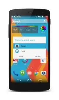

If you consider a Google Nexus device running the latest version of stock Android (4.4 KitKat), the OS presents you with a picker dialog to select which app you would like to launch to complete the task. In the screenshot below, I attempted to launch a camera to take a picture:
this dialog is presented by the OS when more than one application can handle the task you require
Screenshot (click image for larger variant)
You can select one of the options and then select "Always" or "Just once". As the buttons indicate, your selection will either persist for future tasks or you'll see this picker-dialog every time.
If this list changes because you uninstalled the app that you had marked as "Always" or if you installed new apps that can handle the same task, this dialog will be presented again.

You need to perform an action that multiple apps on your device are capable of handling so that the above dialog presents itself. It's hard to know when this dialog will present itself since apps and their capabilities change all the time. For example, if you installed a new camera app, you can make it the "Default" camera app by trying to launch the camera from elsewhere in the system or other apps (like hitting a button that says "take a picture").
