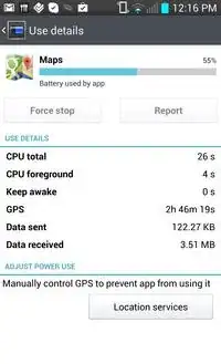

Yesterday I noticed that the G2's battery was draining a lot faster than it had been. I had thought it was just because I had been listening to music a lot more that day, but then when I checked the battery app that night it said that Google Maps was responsible for half the battery drain. I had used it earlier that morning for directions and it had apparently run the GPS in the background for 11 hours straight. I thought it was a one-off, but it happened again today. I've attached a screenshot.
The GPS on my device is off as far as I can tell (i.e. the visual indicator in the tray is dark), so I don't know whether Google Maps is turning it on stealthily and forgetting to turn it off, or whether it's trying to find a GPS signal, can't because the radio is off, and gets stuck in a loop looking for it. I'm assuming the former because there's no CPU activity, just GPS. When I click the "Location Services" button, these are the settings:

Screenshot
Screenshot (click for larger variant)
