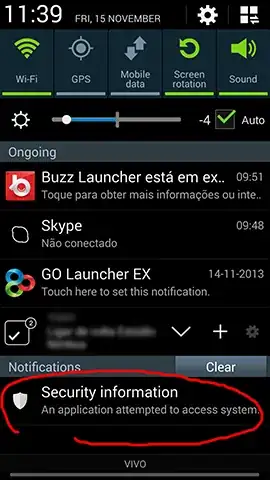

Is there any log where I can check which unknown source app is trying to access the phone without authorization? Lookout keeps popping up this message but don't tell me which application is! It happens whenever I connect to Wi-fi/3G. The application says that everything is normal after a scan. I don't want to remove all applications installed from unknown sources!
I couldn't get the message in english just switching the phone language, it only shows partially in english:
English Message
Portuguese Message

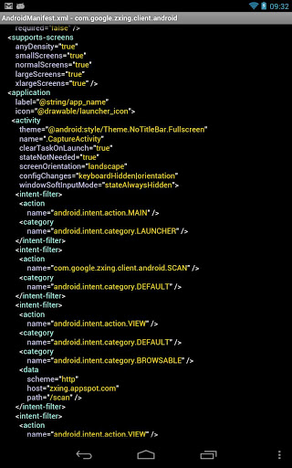

S2 APK Viewer App Detective
S2 APK Viewer and App Detective (source: Google Play)
For this we take a look at S2 APK Viewer and App Detective. Both of them allow to browse the Manifest of your .apks (Apps). Watch out for <receiver>s, which declare what broadcasts an app is interested in.
By these steps, you will not end up with the single candidate, but rather with several. But at least you don't have to check them all. As a broadcast listener can alternatively be declared dynamically by code (instead of in the manifest), our friend might not be listed in the "reduced set" having applied all filters, but must be amongst those left over by the first (permission) scan.
