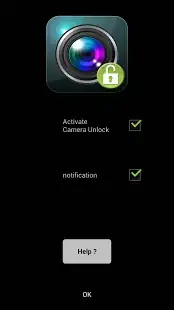

There is no way in Android to access to the standard Android camera from a password-protected device. However this little application allows to access to a simple camera with a triple press on the power button even when the device is password locked...
Camera Unlock (free)
Disclosure: I am the developer of this app

    I've installed the app and I'm currently trying it out. It is rather rough in a number of ways, but based on my extensive searches, it is definitely the closest I've ever seen to what I'm looking for. Thanks! I'll post support issues through the normal support channels for the app. – Tripartio Nov 20 '13 at 20:24
  • Thanks Ochado, I'll try to improve the app. I know it is by now a bit limited, but it starts doing the job ;-) – aeropic Nov 21 '13 at 19:23
  • @aeropic two things would make your app perfect: (1) use slide screen (like in kitkat) or a buton (like in iphone) to open it. (2) let it simply allow us launch our own camera app instead. – cregox Aug 31 '14 at 03:01
