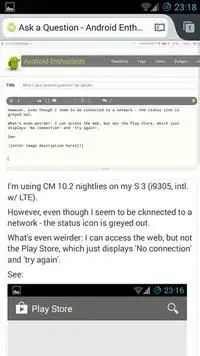

I'm using CM 10.2 nightlies on my S 3 (i9305, intl. w/ LTE).
However, even though I seem to be connected to a network - the status icon is greyed out.
What's even weirder: I can access the web, but not the Play Store, which just displays 'No connection' and 'try again'.
See:
Screenshot
but:
Screenshot
Notice the grey WiFi icon in the top right corner - it used to be blue!
How can I diagnose/fix this issue?

jcora

  • But I can access Google.com and use the Gmail application. And also it has nothing to do with my local network, which is connected to the Internet.
    I think the linked question is completely different. He asks what those icons are, and I'm asking how to fix it. Not to mention we're using completely different versions of Android.
    – jcora Aug 21 '13 at 07:49
  • Have you tried clearing the Google play cache? Have you tried disconnecting and reconnecting to your network? I would also try a quick reboot before you try anything drastic – John Aug 21 '13 at 10:18
  • @John: Cleared cache. Rebooted. Updated OS. Still nothing. Could it be an issue with the drivers or something? – jcora Aug 21 '13 at 10:58
  • Probably not a driver issue, are you using a custom rom? – John Aug 21 '13 at 11:00
  • CM (CyanogenMod) is a custom ROM, yes. (Right? I mean, everything is a "custom ROM", since the carriers and OEMs all modify vanilla Android.) – jcora Aug 21 '13 at 11:15
