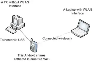

Before going into main question, we do know that :
Now the question is :
"Is there a way to share the reverse-tethered internet (as we known connected via usb0 interface) via "Android WiFi Hotspot?"
To make it easier, here's the schema:
schema
Schema of my setup (click image for larger variant)
*Additional Notes :
  • Actually I don't give a limit which version of the Android (so if it's just compatible in higher version e.g. 4.2, it's okay for me), but I prefer it works on 2.3.x (Gingerbread)
  • Some explanations of how to make APN (Infrastructure Mode) on Android (just like Wireless Router/[netsh wlan hostednetwork] on Windows 7/8) might be really helpful too.
  • And also some explanations about how to masquerade (internet sharing) between two interfaces in Android. (such as ICS in Windows or Masquerade/iptables thingy in Linux-based)

I managed to make it work. Here is an "OSI-like" diagram of my setup, if it makes sense:
 ____________________   ______________________________    ____________
|   LinuxVM <----+  |  |                              |  |            |
|  VirtualBox    |  |  |                              |  |            |
| Windows7(host) |  |  | +--> AndroidPhone <-------+  |  | +-->Laptop |
|  (USB)         +-------+   (USB)  (wifi-HotSpot) +-------+   (wifi) |
|___________________|  |______________________________|  |____________|
The script is located at the XDA forum: http://forum.xda-developers.com/showpost.php?p=50236807&postcount=9
