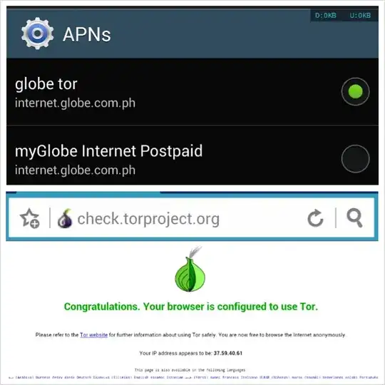

I just installed Orbot awhile ago, and I got it working on my rooted Samsung Galaxy S4. You need to set the proxy for your APN.
Go to System Settings > More networks > Mobile networks > APN. Open your existing APN, and take note of the settings. You need to make a clone of this APN (so that you will still have the original APN, and have another APN that goes through TOR). Go back to the APNs page, and create a new APN, copying the settings from the other APN.
Then, set these:
  • Proxy: localhost
  • Port: 8118
After that, make sure you select the newly-created APN as your new APN. Your network will refresh in a bit. Open your browser and open check.torproject.org. If it was successful, you should see something like this:
WARNING: If you use the GMail app (or in my case, Kaiten configured with my GMail), it may detect unauthorized access, and you may be asked to reset your GMail password online.
