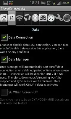

You can give a try to an app developed by a XDA Developers Forum user gyagapen that essentialy the app intelligently manages switching between both your WiFi and 3G data connections as you move about:
CleverConnectivity
App Screenshot 01 App Screenshot 02
CleverConnectivity is an application that helps you to manage your data and wifi connection in order to save battery.
How does CleverConnectivity work?
This application will automatically turn on and off connectivity (data/wifi/sync) while screen is OFF.
For example if the user chooses below configuration:
Time On: 2min
Time On Next Check: 1min
Time Off: 10m
Usage check Interval: 3s
Once the screen is OFF, CleverConnectivity will keep connectivity alive for 2min. Then it will check if data is used during a period of 3s.
If data is used, connectivity will be kept for 1 minute (Time On Next Check).
If data is NOT used, connectivity will be desactivated for 10min. After this, the connectivity will be re-activated and Time On will kick in.
Once screen is ON, connectivity will be automatically re-enabled.
