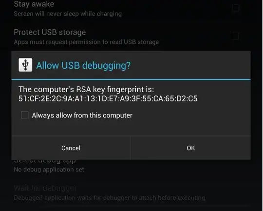

If I plug the tablet in to my Macbook Pro and run adb devices, I get the the RSA fingerprint dialog as I would have expected to see in Windows:
Allow USB debugging?

I have exactly the same device as you, down to the Android version and build number. I discovered that it was necessary to change my USB transfer mode.
You can do this on the Nexus 7 by going to Settings > Storage, clicking on the strange menu icon in the top right hand corner and selecting "USB computer connection". I then changed the storage mode to "Camera (PTP)", and it immediately prompted me with the permission dialog as shown in your post above. I was then able to deploy apps, debug, etc and it all worked.
