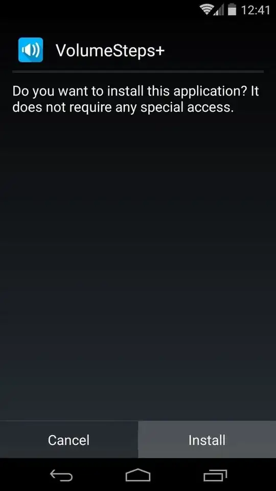

I had initially posted this as an answer to this question: How to increase/decrease volume in smaller increments/decrements?, unfortunately this method won't work officially with Nougat (due to some missing requirements)
The workaround:
As expected, such a modification, will require root or some kind of zip flashing proceedure to install Xposed framework.
Kuba Kalamarz created an Xposed module called VolumeSteps+ which allows one to adjust the amount of steps for every system volume function.
The good thing I noticed about this module is it binds to settings system (i.e you don’t have to open the module UI, instead you can control via the volume button)
Prerequisites
Features
  • Change the number of volume steps for the alarm, music, notification, ringer, system and in-call streams.
  • Ability to change it to somewhere between 5 and 50 steps
  • Use the music volume as default for the Volume Panel when pressing the volume buttons.
Instructions
  1. Download VolumeSteps+ and install
  1. Activate the module in Xposed Settings, and reboot the device to effect changes.
  2. Open VolumeSteps+ in the app drawer
  3. Adjust your volume steps:
    • Each volume category has its own menu entry. Select the one you want to adjust, then use the slider to fine-tune the volume steps, press OK when done.
enter image description hereenter image description here
  • Find the increment that suits your needs.
    1. Reboot (important) your device and the new volume steps will be available, even when pressing the volume button. Viola!
