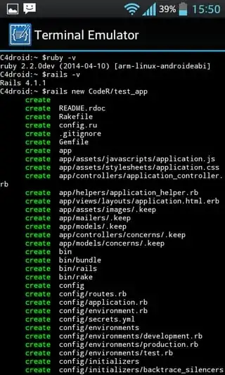

this can be done
  1. Compile Ruby and Nodejs for android
  2. Install on device and configure with c/c++ ide (You can use C4droid,CCTools,Terminal IDE.... for installing the expansion modules on с/с++)
  3. Install rails ($gem install rails)
example:
Screenshot 1 Screenshot 2 Screenshot 2 (Click image to enlarge)
