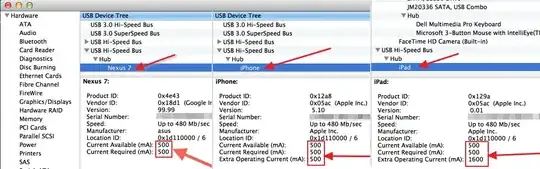

Update: I plugged my iPad1, iPhone5 and Nexus 7 into the same port on my Macbook Pro Retina. I've added a (mashed up) screenshot of all the 3 cases below and it's clear that the Nexus 7 never even demands anything above 500mA on a 2A port despite using the stock cable (and another microUSB cable). I'm now guessing this is a Nexus 7 firmware/software issue. Any fixes? That extra operating current should be 1600mA so it totals to 2.1A (="2A" ports).

    Oh -- you just plugged it to a computer's USB port? That might explain things: The Nexus obviously detects the 'data' pin connected, and assumes it is not permitted to draw more than 500mA (which is the proper USB spec). And instead of trying "different cables and power sources" (as I suggested), you rather tested different devices :) OK, that proves your source is able to provide more power (for the iPad) -- but not whether the Nex has a problem. As said, to me that looks as if it simply "sticks to the specs" -- in this case. – Izzy Apr 10 '13 at 19:40
Two things to consider:
1 Depending on the charger, the Nexus might not recognize it as a 2A charger. It does not actually measure its capacity, but relies on some properties of the otherwise unused data-lines of the USB connection to the charger. Shouldn't be the problem if you used the charger that came with the Nexus.
2 It is possible that the Nexus is confused about the actual state of the battery. This can be re-calibrated, but is a rather involved process - especially if you don't have root on the device yet. However, guides can be easily found with Google.

  • Well there you go, ignore the battery calibration bit. But, the other point still holds. You have to use the charger that came with the Nexus. It may not recognize the Macbook port as being able to supply more than 500mA. The cable does not matter. Have a look at: http://en.wikipedia.org/wiki/Universal_Serial_Bus#Power – user4188 Apr 10 '13 at 22:45
