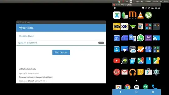

One word: Vysor
Using the vysor to control my Xperia Z2. See the state of my phone, but Vysor came to the rescue.
Using vysor to control my Xperia Z2
*if phone reboots and won't connect after plugging in, try removing the micro sd card. Mine wouldn't work at all until I did so - random phone smasher

  • I wonder what it needs. It tells me on my Android 4.2.1 and 4.4.2 that screen is unavailable and a restart would fix it, which of course is never fixed. On which Android version did you test this tool? – Firelord Feb 19 '16 at 16:23
  • @Firelord Android 5.1.1. You've tried different usb ports? Its hard to tell where the problem lies, but perhaps it might be as a result of the OS version. – KhoPhi Feb 19 '16 at 19:32
