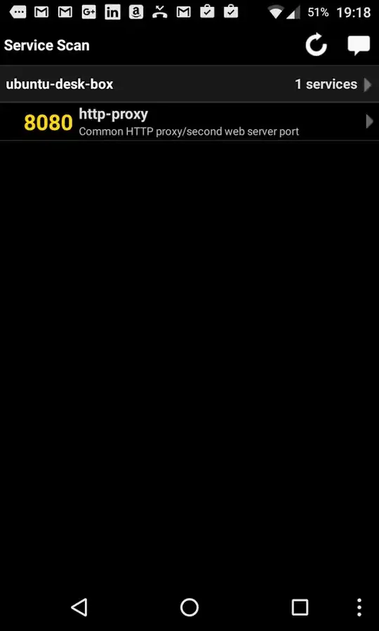

Sadly I work with Ubuntu, so I cannot help you with Windows but this is the screenshot of my PC's firewall status. As you can see, I added a rule allowing incoming traffic on TCP port 8080.
After that I was able to access the server running on the PC. As @devopsEMK said, Fing can give you a hand. Here's the screenshot showing you how you can check that the service is actually reachable from the phone.
