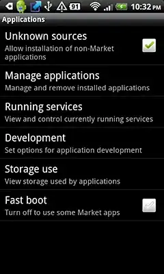

I am on Android 2.3.3 with root, S-OFF and custom ROM (SuperNova) and I can confirm now that the option to toggle between Fast boot enabled and Fast boot disabled is available. Now, to properly answer my own original question, this is how you would disable it on HTC Desire.
  1. Press Menu button.
  2. Tap Settings.
  3. Tap Applications.
  4. Remove the checkmark from the option "Fast boot" to disable it.
  5. Press Home button.
Screenshot:
fast boot option on htc desire

Fast boot in Android 2.3.5 on HTC desire is found under
  1. Menu
  2. Settings
  3. Power
Fast boot option is found in Power
