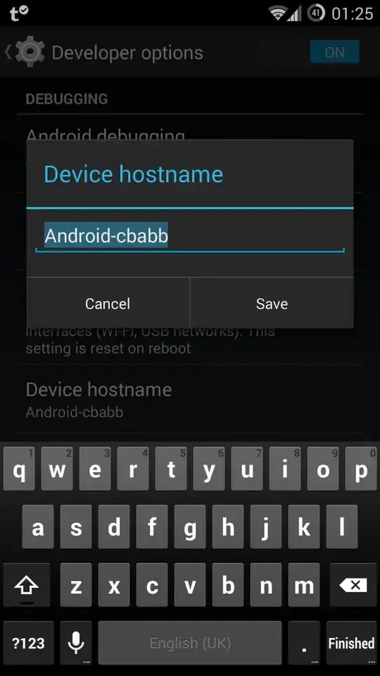

This works on CyanogenMod and probably other modified ROMs but not stock AOSP ROMs:
Go to Settings > Developer Options and scroll down to Device Hostname. Root is not needed.
(Click image to enlarge)
IMG:
endolith
  • 3,035
  • 40
  • 48
    Yeah, you can't do this on an Acer A100 tablet running Android 4.0.3. In fact, it doesn't even have "Device hostname" in the Developer Options. – bgmCoder Nov 04 '15 at 04:14
