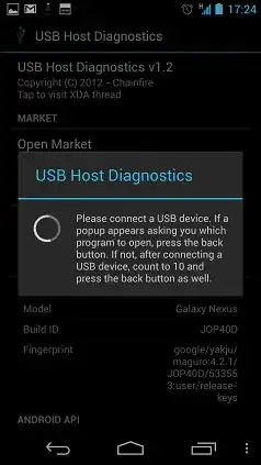

There are some apps that can help you test whether you have all of the necessary hardware and software to do this, such as USB Host Diagnostics. Using it to test your device's capabilities is very simple
  • Install USB Host Diagnostics from the Play Store
  • Run it
  • Tap the Start Diagnostics link, and following the directions first ensure that you have nothing plugged into USB on your device and then plug a device (such as a USB flash drive) in when prompted
USB Host Diagnostics running
