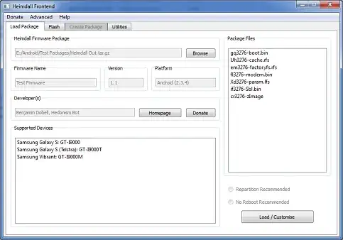

Now, you are 100% correct: As you are no longer able to boot into recovery mode, you need a helper tool "from outside". For Samsung devices, this tool is either Odin (which is what Samsung itself provides), or Heimdall, which is a cross-plattform alternative to Odin which will also run on your Ubuntu PC (Odin will not, as it IMHO is for Windows only). Use either of the two to flash any ROM compatible to your device, so you get your recovery mode working again. Once that is done, you might start over flashing ClockworkMod recovery, then restoring your complete Nandroid backup, exporting your data as described above, and finally switch to the ROM you wanted to use.
Heimdall
