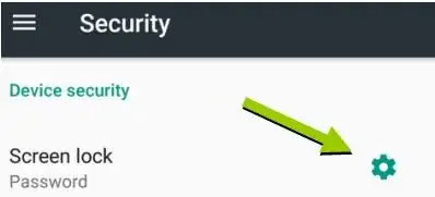

On later versions of Android, the path to get to the above two is under the screen lock gear: settings > security > screen lock (settings gear) > Power button instantly locks, and settings > security > screen lock (settings gear) > Automatically lock.
Gear image on security screen Android 7
