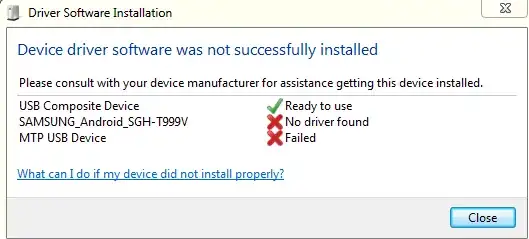

The phone is connected via USB to Windows 7 64-bit. The USB debugging option enabled.
When I connect the phone to the computer, I'm notified that some drivers failed to install.
Do I need these for development? Where can I get them? I have yet to try the Kies drivers.
As is, the device is connected as a "media device", which is useless in terms of development.
When trying an Android SDK sample demo, it starts the emulator instead of running on the phone.
More info about device:
  • Model number: SGH-T999V
  • Android version: 4.0.4

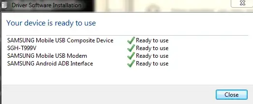

There's no need to install Kies. Download the driver SAMSUNG_USB_Driver_for_Mobile_Phones_v1.5.14.0.exe (or a higher version) which is available from the Samsung website. Click on the Manuals & Downloads tab (below the image of the phone) and then the Software tab.
After installing, I connected the S3 via USB and Windows Update automatically searched for and downloaded a package that was 6.8MB, followed by this notification.
I restarted my computer (just in case) and I can now use the S3 for development, even though it says the device is connected as a "media device".
