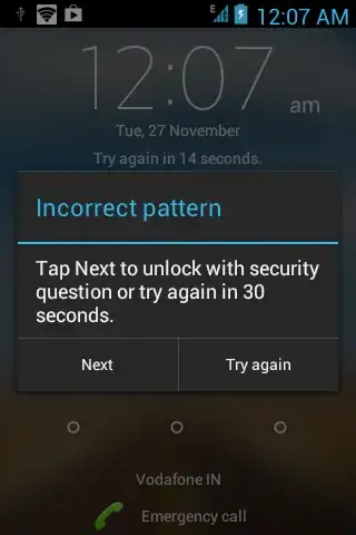

You can reset it very easily with just few steps. I have tested it myself.
1: Enter wrong pattern 5 times and wait for 30 seconds.
2: Select “Next” and enter your G-mail account username and password or you can answer your security question as well. Now just login in your G-mail account and when you authenticated to your G-mail account then the screen will unlock.
Make sure you use the same account that was used to activate the phone and double check the password by logging in to that Google account in a browser.
