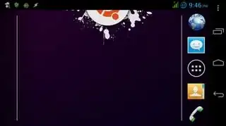

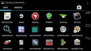

Old question, but this answer is relevant for other Android versions.
I suffer from the similar problem in my Android 4.2.1 where all apps would follow auto-rotation except the home screen (default Launcher app). I found a solution mentioned here and here.
The device needs to be rooted and Xposed Framework installed. App Settings is the app that did the job in my device.
Instructions
  1. Install, activate and launch App Settings.
  2. Locate and select your default launcher app → slide to ON.
  3. Change Orientation to Normal rotation if you want orientation to be synced with auto-rotation, or choose other ones based on your needs.
  4. Tap "save" icon next to ON to save settings.
  5. Go back to Launcher, and as per your settings you will notice the orientation in it.
    Default Launcher in landscape mode with auto-rotation
    IMG: Launcher in landscape mode with auto-rotation
    App drawer in landscape mode with auto-rotation
    IMG: App drawer in landscape mode with auto-rotation
We're good to go!
