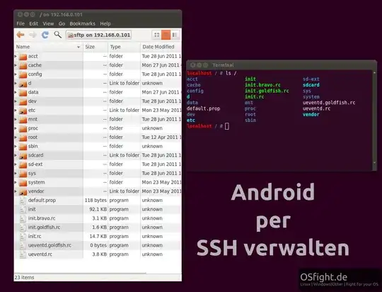

If you have a wireless network set up I can recommend to connect via SSH. It allows you to access and fully manage your Android in a few minutes. For Linux or Putty users there is no difference to a standard terminal using SSH besides some specific Android commands. Moreover, some file managers such as Nautilus support the SSH protocol so you will have the flexibility of a shell and additionally the comfort for file operations using a graphical file manager. I liked SSH so much that I have written a small how-to for Android (in German). I know, it might not fully apply to your question but can be considered while working with an additional computer and an Android phone.
An easy to use SSH server is SSH Droid, available in the Google market.
n3rd
  • 507
  • Do you mean set up an SSH server on the phone? That may be more trouble than it is worth. – Zhehao Mao Jun 29 '11 at 13:31
  • I installed SSHDroid in no time and it is definately less complicated than setting up the Android SDK / ADB shell (check my tut). If you are experienced with SSH you will appreciate it for accessing the phone. – n3rd Jun 30 '11 at 00:03
  • Huh, I had no idea. I would read your tutorial, but I don't know German :-). – Zhehao Mao Jun 30 '11 at 00:14
  • I am going to add an English translation in the near future. – n3rd Jun 30 '11 at 09:36
  • How exactly does it work? Does the SSH connection go over the USB cable? – Zhehao Mao Jun 30 '11 at 13:10
  • My setup at home consist of a router with wifi and a computer connected to it. My android phone is connected to the wifi as well. From the computer you can access the phone simply by using "ssh [email protected]" whereas 192.168.0.100 is the IP address of my phone. Thats it. Connecting to your phone via USB / Bluetooth check out this question link – n3rd Jun 30 '11 at 13:48
