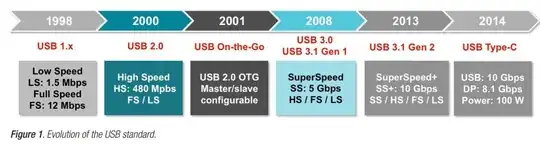

Note: This answer is an educated guess based on my understanding from Guide to USB-C Pinout and Features and anyone with a better understanding is welcome to improve
From a historical perspective USB standards evolution is as depicted
Since USB Type-C is the de-facto standard, the answer is based on this standard. Figure below shows the configuration of USB-C receptacle (plug is similar with minor changes)
