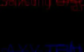

I get a folder fbresult/ created, where different attempts at decoding can be seen. Here's the interesting part:
  • For me, /dev/graphics/fb0 held the Samsung boot logo (I got the correct decoding, but liked this one):
  • However, /dev/graphics/fb1 is always blank
So, probably this is not the right thing - to go back to Why is the FrameBuffer missing on some Android devices?:
