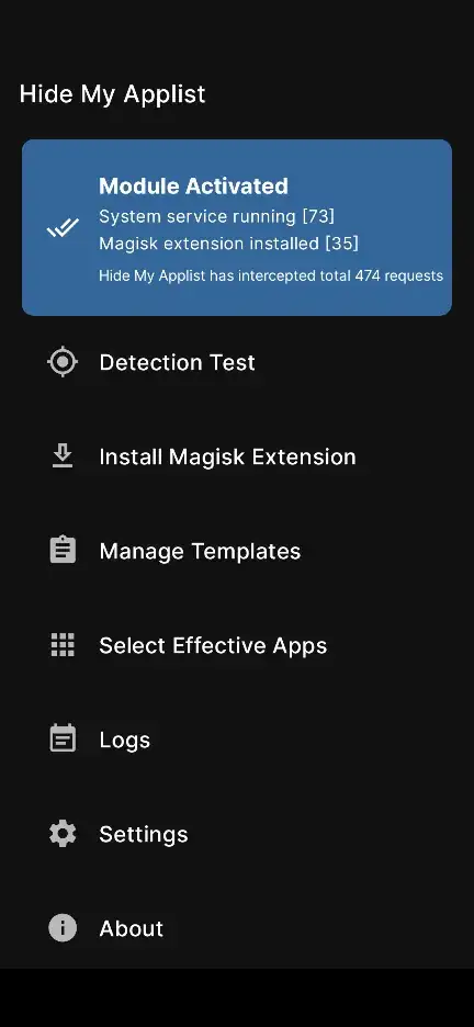

Configuration instructions; I didn't find clear instructions on how to use this, so detailing the process below
  1. Install it through Magisk and when you open the app in LSposed manager, you get this view. Do not select/modify anything other than default (default being system framework)
  1. Click on the cog wheel at bottom right to open the module interface
  1. First thing is to install Magisk extension (Riru or Zygisk, it was the second one for me being on Zygisk based LSposed set-up. Ignore this step and you will be rewarded with a boot loop.
  2. Click on detection test, it will download an app Applist detector and when you run it , you would see red in most places all related to Xposed modules or LSposed framework
  1. Manage Templates: You can create whitelist or blacklist templates. Select blacklist and add all Xposed module related package names like org.lsposed.manager, eu.faircode.lua etc., and com.tsng.hidemyapplist , which is the package name of this Xposed module. Save (icon at top right corner) Essentially, blacklist contains all the packages that show that the device is rooted. You can create as many templates as you want (more about that later)
  2. Select Effective Apps: This is a list of apps from which you want to hide the blacklist like your banking apps, for example vn.com.techcombank.bb.app (Vietnamese banking app). Include in this list com.vsng.applistdetector which is the package name for the app downloaded in Step 4. Configure as explained:
  • Enable hide
  • Work mode (Blacklist) -default setting
  • Enable all hide methods.
  • Copy this config to quickly pick and apply to all such apps
  • In template config, choose the blacklist template you named and saved (Step 5)
  • Save.
Run the app list detector check, see all blue (in my case suspicious package in abnormal environment is related to Xprivacy Lua) but that was not a problem
You are good to go!
