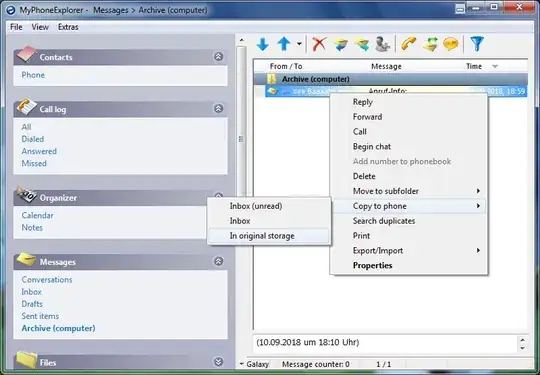

Finally, install MyPhoneExplorer and backup your SMS. you can restore to different phone by copying the files into proper directory and restore it -> "In original storage"
%UserProfile%\AppData\Roaming\MyPhoneExplorer\<device>[<IMEI>]\SMS.dat
%UserProfile%\AppData\Roaming\MyPhoneExplorer\<device>[<IMEI>]\SMSArchive.dat
