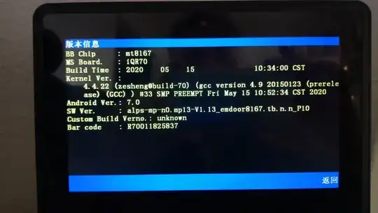

I am new to the Android programming world. I own an iQR70 device from MLS that is using -if I read well- the kiosk mode for its own application called MAIC (something like Amazon's Alexa, a virtual assistant).
The real pain with this device is that the application is buggy, does not get any updates, and overall does not work properly.
So, my questions are:
  1. Is there any way to disable the kiosk mode and work with it as a normal tablet? Or desperately,
  2. Can I install compatible firmware? I don't care for the data inside.
I tried to install a stock firmware "Version: MLS iQR70 – 7.0_MT8167_V1.0_20180111-B1" from https://firmware247.com/mls-iqr70-firmware/ using "Format all + Download" using MediaTek SP Flash Tool v5.2052.00 and now it does not power up. It doesn't even connect anymore with the SP Flash Tool.
Is the device completely dead? Is there any way to revive it? I have two of them, can I download/upload the firmware from the good one to the bad one?

  • unfortunately "format all + download" will erase secro persist and other important partitions. but the issue is probably flashed wrong preloader which bricked it completely (not sure about, preloader is for iqr-70 and should still work). disconnect battery and try again – alecxs Apr 30 '21 at 09:06
  • @alecxs, so there is no chance to revive it anyway? – Maverick Apr 30 '21 at 09:08
  • there is meta mode if you can figure out kcol0 test point https://forum.hovatek.com/thread-11802.html – alecxs Apr 30 '21 at 09:14
  • @alecxs thank you, I will give it a try. Can you tell me please if I can quit/exit from the "kiosk mode" of the virtual assistant that comes with this tablet? In the other one I own, I have no access to anything but the virtual assistant. I can get in ADB mode but the device is not listed and I can use the fast mode which OEM unlock is not allowed. What are my options? – Maverick Apr 30 '21 at 09:24
  • @alecxs This device does not have a battery at all but I formated also the preloader.... which as far as I understand is the connection with the hardware itself. The problem where is that SP Flash tool can not see the device anymore!!! – Maverick Apr 30 '21 at 09:25
  • regarding adb: you can try to flash modified boot.img if it is signed AVBv1. check with AIK it will tell you during unpack. instructions – alecxs Apr 30 '21 at 09:27
  • "format all + download" only erased EMMC_USER (not preloader EMMC_BOOT). if device does not have battery disconnect power supply, preloader works without any power source – alecxs Apr 30 '21 at 09:30
  • @alecxs I already did, but I get no response using SP FLASH. I think its totally dead!!. I will try the hardware solution. Regarding adb, you said to flash the modified boot.img. It seems that the firmware I downloaded it was incorrect for this device. So can I download the original boot.img to my HD and modify it someway? – Maverick Apr 30 '21 at 09:35
  • do a full read back of the working device https://android.stackexchange.com/q/203283 – alecxs Apr 30 '21 at 09:38
  • @alecxs ok I will try. The "bad" one using ONLY the USB cable does not respond to "ReadBack" command using SP Flash, which means only hardware intervention, am I right? – Maverick Apr 30 '21 at 09:42
  • not sure, depends on what you mean with "respond". order is important. 1.) start read back 2.) connect usb cable. VCOM preloader drivers must pop up for ~1 second in windows device manager each time you connect – alecxs Apr 30 '21 at 09:44
  • That's the correct order I followed, I tested also the good one and it worked immediately. The bad one does not respond to anything I tried so far. – Maverick Apr 30 '21 at 09:45
  • maybe there is a battery inside you don't know? – alecxs Apr 30 '21 at 09:47
  • @alecxs A small internal batter like CMOS for time/date? Yes, maybe but its a compact device that I didn't open as you can see in the attached photo. – Maverick Apr 30 '21 at 09:51
