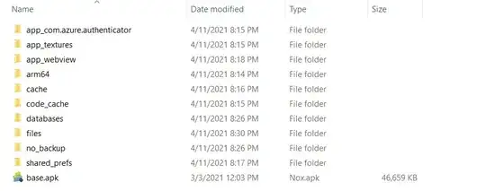

  1. Next, I had to look through all of the ".tar"(s) and find the one that had the _\data\data\ directory, from there, I found the com.azure.authenticator folder
  2. I opened the com.azure.authenticator folder, and then found and opened the databases folder
    Me finding the "databases" folder

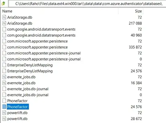

  3. Then I looked for the PhoneFactor database file which contained all OTP-related information for Microsoft Authenticator (I made sure it was not the cached version -> I was able to tell which was the cached version by comparing the two PhoneFactor files and determining which is bigger, the bigger one is the "actual" file --- It seems all of the "cached" files have a size of 72 bytes)
    Me opening the "databases" folder
  4. I extracted the PhoneFactor file to an accessible location -> downloaded an SQLite Viewer application (I chose DB Browser for SQLite) -> and proceeded to open the PhoneFactor file with the SQLite viewer
