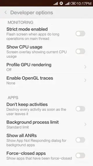

To achieve such a situation, user needs to awake its developer mode. There is an option related to apps. Background Process limit : There you can set how many apps be in background and do you want to leave them.
But proceed with CAUTION! on these settings.
