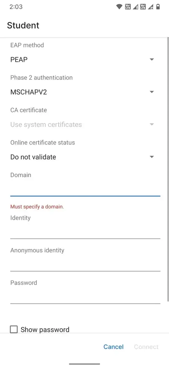

I can't connect to campus WiFi anymore after installing latest ROM with december 2020 security patches. The configuration is PEAP/MSCHAPV2. Under CA certificate, we usually choose "Do not validate" but now CA certificates is set to "Use system certificates" and can't be changed. "Use system certificates" setting requires Domain name which I don't know and have never needed to use before in any ROM.
See the screenshot.
Is there any workaround to choose "Do not validate" in "CA certificate"?

    The behaviour is as intended in Android 11 with December 2020 security patches. See the link. This will need to be resolved by WiFi network administrators. – Yogesh Yadav Dec 12 '20 at 09:00

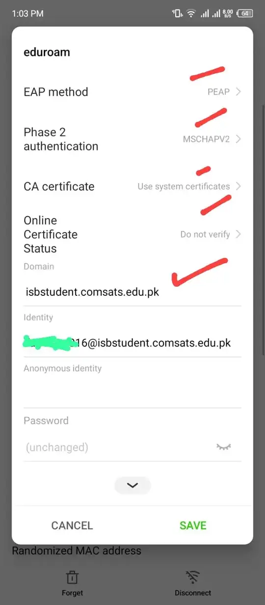

Well you can try to fill in the last part of your email addresses for domain - so everything after the "@". like my last part of email address is isbstudent.comsats.edu.pk As written in one of the guides, normally you would enter the domain address of the authentication server / the common name which is part of the certificate of the server... It worked for me!!!enter image description here
