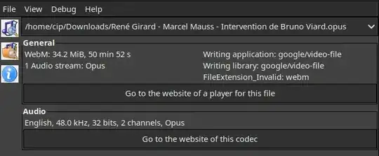

Opening the audio file in Audacity, I see this:
Although Mediainfo says 2 channels:

  • @AndrewT. - Taking the ogg audio from youtube on my computer and using Audacity, I have exported it as a mono mp3 which indeed is heard fine in both headphones. On the other hand (as seen at the link you posted) that other out-of-phase stereo file was not played at all on a speaker but was played fine on (I guess both) headphones. Mine is played by the single external bluetooth speaker, as well as by one of the two headphones. There might be a difference here. – cipricus Aug 27 '20 at 10:21
    Err... looking from your screenshot, I'm afraid the audio source is actually stereo, but the audio is only recorded on 1 channel, which makes a big difference than a true mono audio :( but I'll check myself later. Meanwhile, you might be interested in music player apps that can select only 1 channel to be played on both channel (not sure for the keyword though) – Andrew T. Aug 27 '20 at 11:01
As the youtube audio in question is not a mono but a stereo with just one channel (Audacity was right, Mediainfo was wrong), a solution is exactly the one that initially seemed to me the opposite of what I wanted: rendering the file as mono — and thus, playing it through both headphones.
