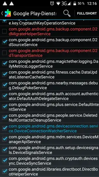

One mitigating measure against Google Play Services' tracking is to root your device and use app like cn.wq.disableservice. With this you can have control over GMS and block single actions, like prevent GMS from updating itself. It's painful to understand all the things but it should be technically possible to block data transfers.
disable-service
