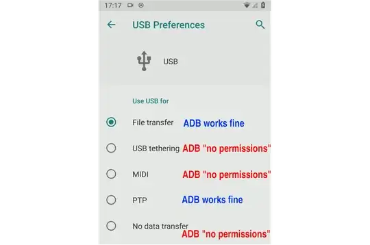

It seems that I can only get ADB permissions for my device only while in MTP or PTP mode and NOT in USB tethering mode, which is what I need.
I have done plenty of research but I stumbled upon so much contradicting and very old information that I can no longer see how to proceed.
Here they say that it is not possible, but it dates back to 2012. Here and here they propose to invoke the shell via ADB to put the device in USB tethering mode (which works for me as well) but also to disable it, which in my case fails since as once stepped away from MTP or PTP mode I no longer have permissions for my device.
Then I found this interesting post which seems relevant but does not provide a complete solution. This also looks relevant but it does not touch the tethering case.
So, once and for all, how do I keep ADB permissions for my device when it is NOT in MTP or PTP mode? I only care about recent Android versions. I obviously have root access for my device as well the possibility to deploy custom ROMs, although, for personal taste, I tend to stick to LineageOS.
Additional note: this is the error that I get when not in MTP/PTP:
$ adb devices
List of devices attached
2d8568f6    no permissions; see [http://developer.android.com/tools/device.html]
$ adb shell
error: insufficient permissions for device
See [http://developer.android.com/tools/device.html] for more information
Unfortunately the link is quite useless, but it seems that ADB identifies and communicates with the device, but this does not accept any request.
I don't think that this has something to do with my PC, the udev rules are in place, plus ADB works fine when the device is in MTP or PTP mode.
Here is a screenshot (click for video browsing to that menu):
dsc

  • That seem to be a device specific problem (-> edit your question and add device details). My Sony XA2 works out of the box with USB tethering and ADB at the same time (however MTP seem to be disabled while USB tethering is active). – Robert May 02 '20 at 11:05
  • @Robert I am trying with a lenovo k6 (karate k33a48). I have the feeling that in the past it used to work, but I cannot remember what ROM I was using. I expect this to be a software issue, possibly device unrelated. – DarioP May 02 '20 at 12:53
    Note: Your question is a bit misleading as you always talk about "adb permission". However this is not a permission problem but a configuration of the USB interface. Each physical USB device can have multiple logical devices active at the same time (on my device one for "Remote NDIS" and one for adb or one for adb and one for MTP). On Windows you can view them nicely in the device manager grouped by a USB compound device (virtual device that combines the logical USB devices). Hence your question is how to activate RNDIS and adb at the same time. – Robert May 02 '20 at 13:06
  • You should add this very important info into your question and not hide in comments. However I still don't think that this is a permission problem. The adb permission uses public key auth, hence the permission can't just change. I suspect a bug in the firmware of your device or a general bug if others can reproduce your problem. – Robert May 02 '20 at 13:30
  • @Robert I will just try another rom, but It's a pity because that doesn't lead to any understanding of the issue. – DarioP May 02 '20 at 13:33
  • If your device is rooted and it uses sysfs interfaces to configure USB functions, you can edit init's .rc files to write adb and rndis at the same time (as it writes adb and mtp together). The same should be achievable if your device uses configfs interfaces. // If the problem is only about ADB permissions (and not that tethering and ADB cannot be turned ON simultaneously), all that you need to do is add the USB VID/PID to your device manager (e.g. udevd) on PC so that proper permissions are set on USB interfaces in /dev. There's nothing to be done on phone. – Irfan Latif May 02 '20 at 14:05
  • @IrfanLatif not really. My udev rule is in place and works fine when in MTP/PTP mode. The answer which suggest to change usb mode is quite silly in my case. See the edits for the .rc files. – DarioP May 02 '20 at 15:58
  • MTP/PTP uses a different USB VID/PID, usually that provided by Google in AOSP. Tethering (RNDIS) is a hardware-specific USB mode, so OEM's VID/PID is exposed to PC. Mostly Linux distros recognize MTP/PTP out of box because that's a generic case. But there is a long list of Android phone vendors, so not every Linux distro recognizes every vendor (VID) and every of its product (PID). I suggest you read about how USB VID/PID works, instead of blindly resisting. – Irfan Latif May 02 '20 at 16:55
  • @IrfanLatif Thank you for your persistence. That was indeed the case: the product ID changed slightly when in tethering mode and I did not have the proper udev rule. I transferred this knowledge in the archlinux wiki: https://wiki.archlinux.org/index.php/Android_Debug_Bridge#No_permissions_error If you make your comment an answer I would be happy to accept and upvote it :D – DarioP May 02 '20 at 17:25
    @DarioP I'm glad it helped. I think the question I linked already includes the relevant answers. Reposting isn't encouraged. – Irfan Latif May 02 '20 at 17:55
  • This is the answer to my question: https://android.stackexchange.com/a/195443/322110 – DarioP May 02 '20 at 18:38
