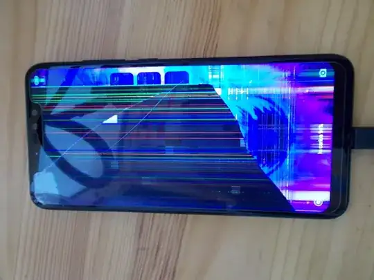

My Xiaomi Redmi Note 6 Pro broke and 3/4 screen is completely black, I can't see anything but a little part below
Other than that, the touch doesn't work AND sometimes the screen triggers some random coordinate touch. If that's not enough, Xiaomi devices must be unlocked at least 1 time after startup with pattern, but can't. I usually use biometric unlock such as fingerprint sensor and facial recognition but, again, can't.

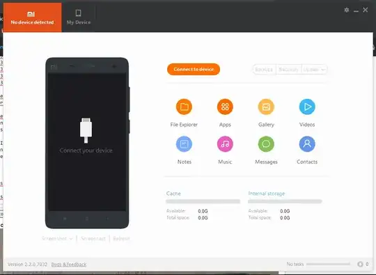

I tried also Mi Suite with no luck: although I connected my device it shows this:
