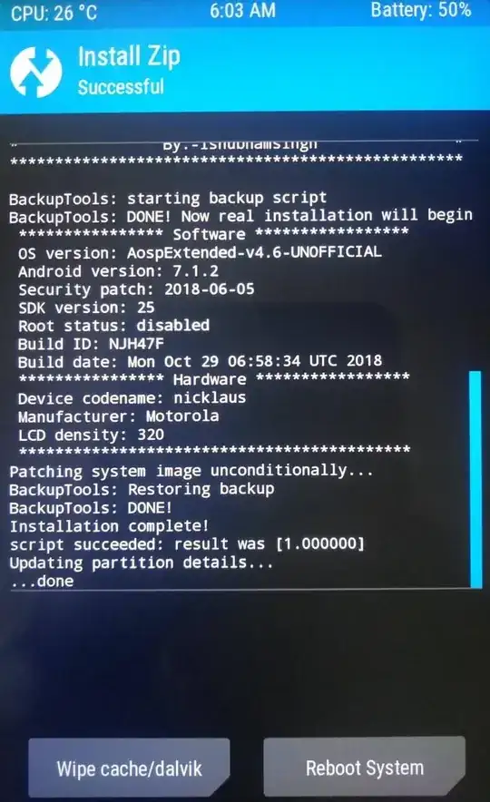

Successfully installed the AOSP Extended image for 'nicklaus'. Whenever I reboot my device to boot my device, instead of booting to the custom ROM my device automatically boot itself into TWRP recovery, as if like there is no ROM installed at all.
TWRP screenshot
I'm trying to flash AOSP extended or any other custom ROM to my device ('nicklaus' Motorola E4 Plus). After wiping the internal storage (dalvik & cache) and then successfully install the custom ROM.
Actually I flashed .zip file, GApps, and then reboot the device, the device automatically boot itself into TWRP recovery mode. Previously, I fixed my file system problem and then tried multiple times to install compatible ROMs. However, nothing helped at all.
After uninstalling stock ROM. I actually flashed ViperOS, Lineage, Remix OS and AOSP extended as well. But after fixing the file system issue nothing helped me to flash any ROMs.
