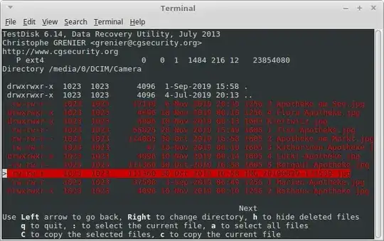

for Mediatek devices do following:
if your device is encrypted
  • get a temp root shell with mtk-su
  • dump your decrypted userdata partition /dev/block/dm-0
    (this will take ~25 GB/h)
    sudo apt-get install android-tools-adb extundelete testdisk
    adb push mtk-su /data/local/tmp/
    adb shell chmod 0755 /data/local/tmp/mtk-su
    adb shell /data/local/tmp/mtk-su -c "cat /dev/block/dm-0 2> /dev/null" > userdata.img
if your device is not encrypted
  • switch off device, remove battery (if possible)
  • install VCOM preloader drivers (Windows)
  • find a scatter file for your ROM
  • download SP Flash Tool (Windows)
  • do a read back of userdata partition (SP Flash Tool)
once you have a ext4 disk image of userdata:
  • open userdata.img with testdisk (linux)
  • copy deleted files, or
  • scan the whole userdata.img with extundelete (linux)
    testdisk userdata.img
    [Proceed ]
    [None ] Non partitioned media
    [ Advanced ] Filesystem Utils
    (press Enter 3x times)
    [ List ] List and copy files
    (deleted files are colored red)
    a to select all files
    Shift + C to copy the selected files
    (select destination folder)
    C when the destination is correct
    testdisk
    extundelete userdata.img --restore-all
    (check folder ~/RECOVERED_FILES/media/0/)
