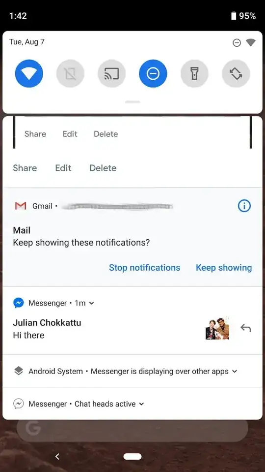

Pull down the notification shade. If it looks like this: Android 6.0
It is android 6.0
Android 9.0
It is android 9.0

    Thanks, looks like it's android 6.0 then. I guess the only thing that would give this kind of result is a tampered with version of android, made to show these results in About Phone? – Steven Haggerty Jul 16 '19 at 20:38
    @StevenHaggerty Certainly possible and likely not very difficult. If you plan to continue to use this phone I would install a clean version of the OS on the device as you can't know what other changes have been made. Or try to get a refund. – Qwertie Jul 17 '19 at 07:27
    @StevenHaggerty Note that android 9 was released in August 6, 2018, and your screenshots show that your phone has the security patches from May, 2017, another sign that there was some tampering – Ferrybig Jul 17 '19 at 08:51
    @StevenHaggerty with root and build.prop, it's possible for anyone to fake the Android version (ref: MIUI forum) – Andrew T. Jul 17 '19 at 09:10

    While this is a useful quick check, it's worth noting that many builds of Android are heavily customised by OEMs (e.g. Samsung's "Touchwiz"). It would be perfectly possible to build a ROM based on Android 6 that looked very like your second screenshot, if someone was trying to pass off the phone as something that it wasn't. The system information in Nzall's answer seems a much better clue. – IMSoP Jul 17 '19 at 16:36
    I agree with IMSoP. While useful as a "quick check" this is far from foolproof (my old stock LG phone running 6.0 looks closer to the "9.0" screenshot than the "6.0" screenshot!). The process in Nzall's answer, while a bit more involved, provides much more concrete confirmation. – Doktor J Jul 17 '19 at 19:17
