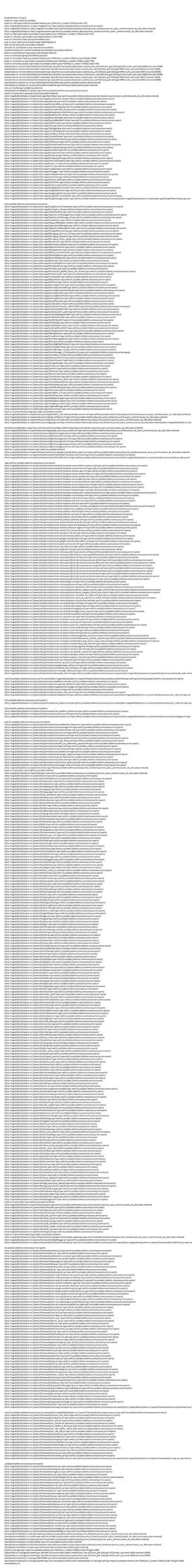

Print env o/p Mount o/p

  • post the output of mount and printenv somewhere (pastebin) after mountscript – alecxs Jul 14 '19 at 02:50
  • I dont see any place where I can paste the full o/p due to restrictions in #chars so I attached screenshots. Need to see that mount @ 300% I was able to read some - the file gets toned down in size & quality even if < 2mb ( max allowed ) – user1874594 Jul 14 '19 at 21:55
  • see pics attached – user1874594 Jul 14 '19 at 21:55
  • from mount what i can see your first partition is mounted twice. from printenv i can see you have knox? – alecxs Jul 14 '19 at 23:23
  • Knox is disabled or removed. Prolly 1st – user1874594 Jul 15 '19 at 01:08
