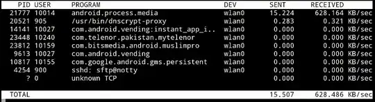

NetHogs traverses procfs and copes with the above limitations (though not always very successful):
